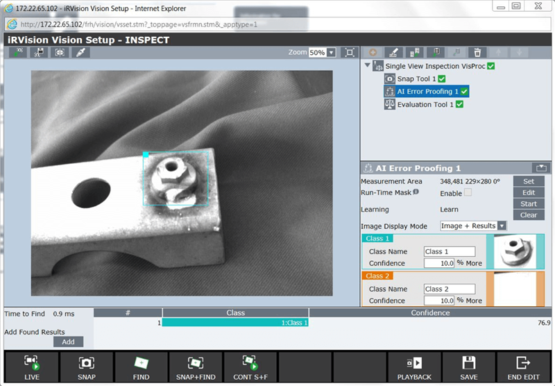

Figure 1 shows an example of AI Error Proofing finding a welded nut on a shock mount bracket. Examples of the welded nut and the missing nut were used in AI Error Proofing’s learning process. In the example, class 1 was trained with the nut and class 2 was trained without the nut. Figure 1 shows the welded nut in class 1, highlighted in cyan.
Figure 1 Trained AI Error Proofing

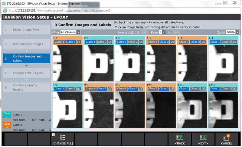

Figure 2 shows an example where the operator differentiates between examples. The operator classifies a plastic applicator with a lid as class 1 and without a lid as class 2. All class 1 examples are cyan and class 2 examples are orange.
Figure 2 Classification

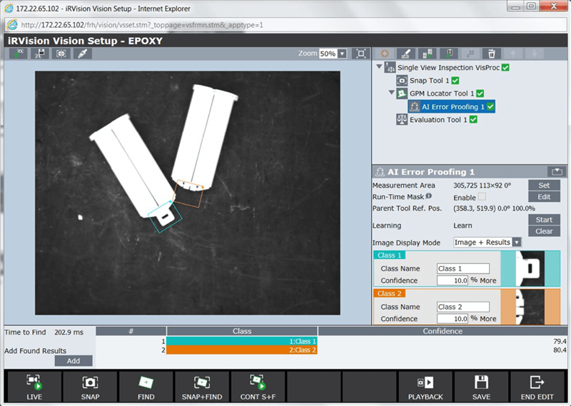

Figure 3 shows the results of the classifications from Figure 2. Multiple objects may be classified in the same image. Figure 3’s example shows two different applicators. The one with a lid is highlighted in cyan and the one without a lid is highlighted in orange. In this case, iRVision’s GPM Locator Tool identified the location and orientation of the applicator. Combining the GPM Locator Tool’s pattern matching ability with the AI Error Proofing Tool allows parts to be found and classified at the same time in the same image. The combination of these tools allows the robot to pick plastic applicators from a conveyor and place the ones with a lid into the filling machine, and the ones without into a reject bin.
Figure 3 Found Results
