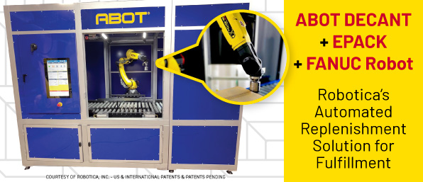

Now, ABOT M1 is available with state-of-the-art FANUC industrial
robots, metrology and the AI capabilities to support decanting of
products into totes. ABOT M1’s computational and sensing
power makes it the industry’s next-generation intelligent platform
for automated decant processes, providing easy integration with
goods-to-person AMR systems and other automated processes or work
cells.

Robotica’s industry leading second-generation ABOTm-1 for automated
decant is a natural progression following years of experience designing
and producing multiple commercialized automated box opening
technologies. Now, the ABOTm-1 uses data elements to successfully
open boxes without damaging the inner pack contents. Generation
one systems required an operator to input data for various packages, and
used a manual database to maintain the information. However, it
quickly became clear that a manual database would not be effective for
many eCommerce warehouses that process tens of thousands of SKUs with
constantly changing packages and shipping cartons. Plus, in
today’s fast-moving distribution culture, maintaining a manual
database with this magnitude is far too labor intensive and time
consuming.
The ABOT Generation II uses autonomous learning of box dimensions and
cutting metrics. This method provides effective data management, and the
ability to accurately open an ever-expanding range of box sizes and
configurations while protecting the inner packs. The AI module
allows for continuous learning and improvement that can be shared across
multiple ABOTm-1 machines in a network.
ABOT +
ePack - The Ideal Decant System Solution – Features &
Benefits
The combination of ABOTm-1 box opening with decant and a FANUC robot into
ePack technology is offered in two standard modular production models
for quick delivery and installation. ABOT+ ePack systems are
easily configured and integrated into micro-fulfillment and large DC
applications. For example, a single ePack-Micro processes up to 400

Robotica’s decant automation can be integrated with robotic
material movement or an existing conveyor. The ePack technology
simplifies material movement for decant. Replenishment supply (donor
cases) and order inventory (totes) can be handled, buffered, and
managed.
The ePack systems easily interface with various AMR or goods-to-operator
robotics without special programming or interface equipment. In
addition, ePack is adept at receiving and delivering inventory totes to
and from static shelf positions or onto a takeaway conveyor. And,
ePack can access totes randomly for buffering, SKU matching and/or
compartment matching.
Pre-programming ePack for specific SKUs or item shapes and case sizes is
not required. First time cases and contents are automatically handled
based on rules constantly fine-tuned by ePack’s AI.
