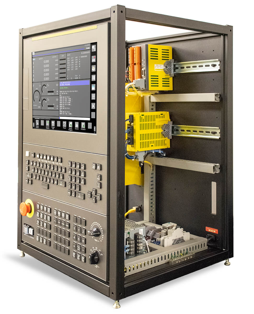

FANUC Hardware Simulators gives your team the opportunity to learn and troubleshoot without affecting productivity. Offline CNC simulators let machine operators, programmers, and maintenance/engineering personnel learn new skills, test new approaches and troubleshoot existing programs without taking a machine out of production. CNC hardware simulators are a fraction of the cost of using production equipment and come in several configurations to match your production machines, including:
  • 21.5” LCD Touch Panel Display (Horizontal or Vertical)
  • 19” LCD Display (Horizontal or Vertical)
  • 15” LCD Display (Horizontal or Vertical)
  • 10.4” LCD Display (Horizontal or Vertical)
  • PANEL i or Dedicated LCD Displays are supported
  • Alpha-i Servo 3-axis Motion Simulator
  • Beta-i Servo 3-axis Motion Simulator
The Hardware Simulators come with a black anodized aluminum frame and includes front, rear and bottom mounting plates as well as required supporting cables and a +24V DC power supply. The rack and CNC control have basic parameters and PMC ladder logic preloaded. FANUC CNC system components can be ordered separately. Open sides provide easy access for engineering development and maintenance training.
