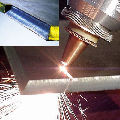

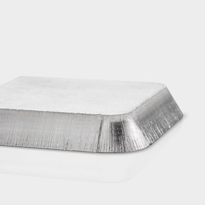

Bevelling
When it comes to bevelling, CO2 is more accurate than plasma cutting and faster than milling. A good CO2 machine will allow you to bevel edges of up to 40 mm - the perfect solution for cutting steel plate.

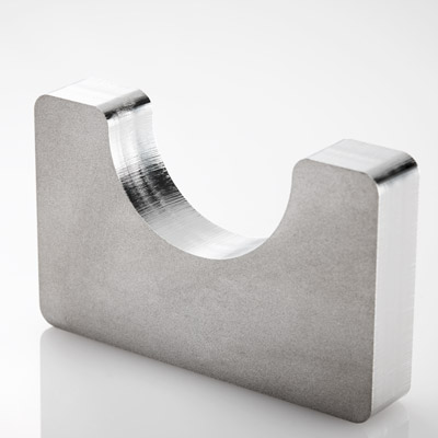

oxide-free-co2-cutting-part
Oxide-free Cutting
CO2 lasers cut clean without leaving oxide residue on the workpiece. This makes using a C02 machine a great alternative to milling on stainless steel parts requiring an excellent finish. Given extra productivity resulting from its speed, it makes sense to seek advice on the pros and cons of laser cutting as an alternative to milling.

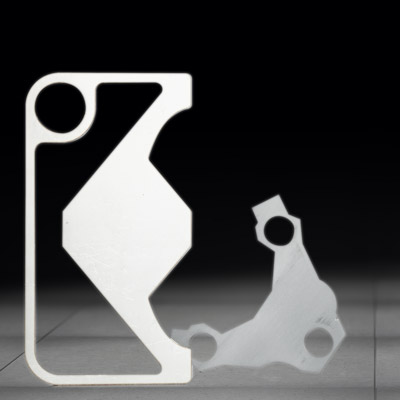

Intricate Shapes and Tiny Grooves
CO2 machines make it possible to cut intricate shapes and tiny grooves down to a fraction of a millimeter.
