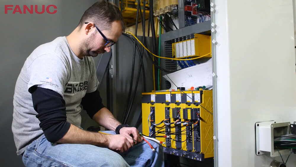

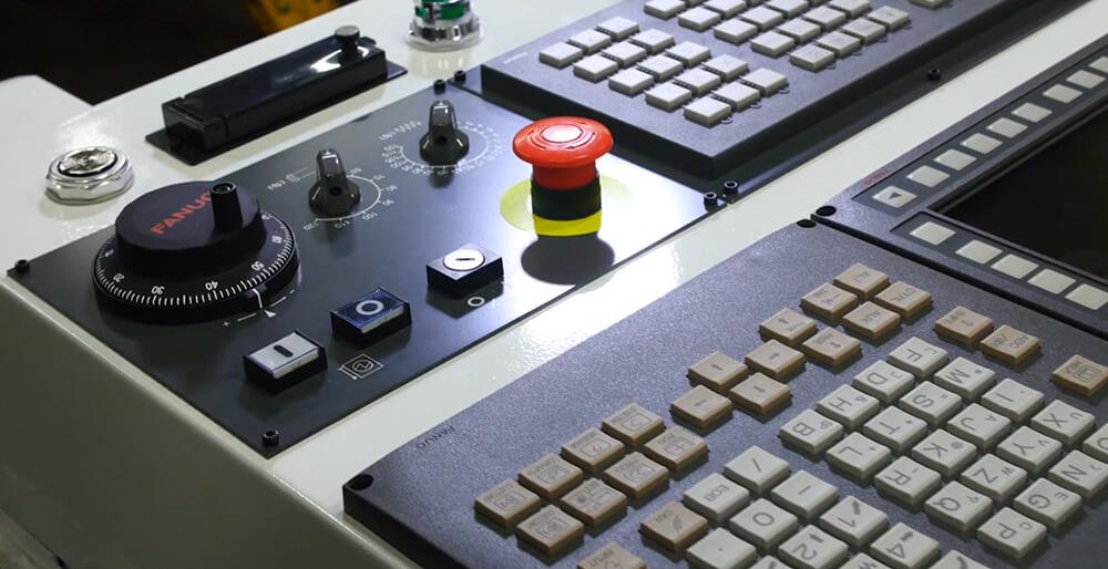

A CNC retrofit upgrades the control system, the servo and spindle motors, the motor amplifiers, cables and I/O units including the operator’s panel.

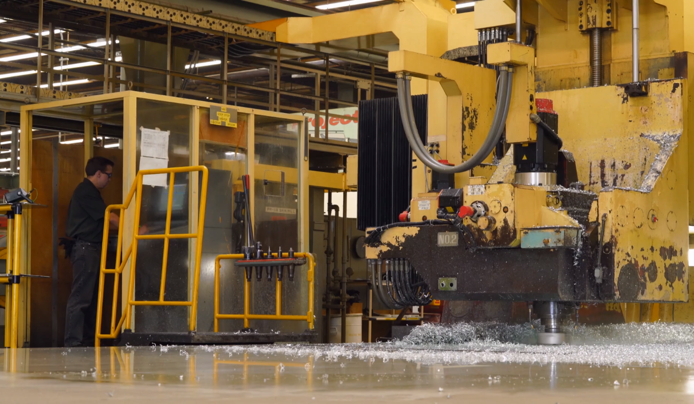

Aerospace Skin Milling
Production Benefits from Retrofitting
Learn more about how Microtrol Engineering helped retrofit Cincinnati skin mills with new FANUC controls, motors and drives to boost quality and efficiency. “I always recommend FANUC,” says Brandt Fine, president of Microtrol Engineering. “FANUC is a solid platform. I install, and I don't have to worry about it breaking down.”

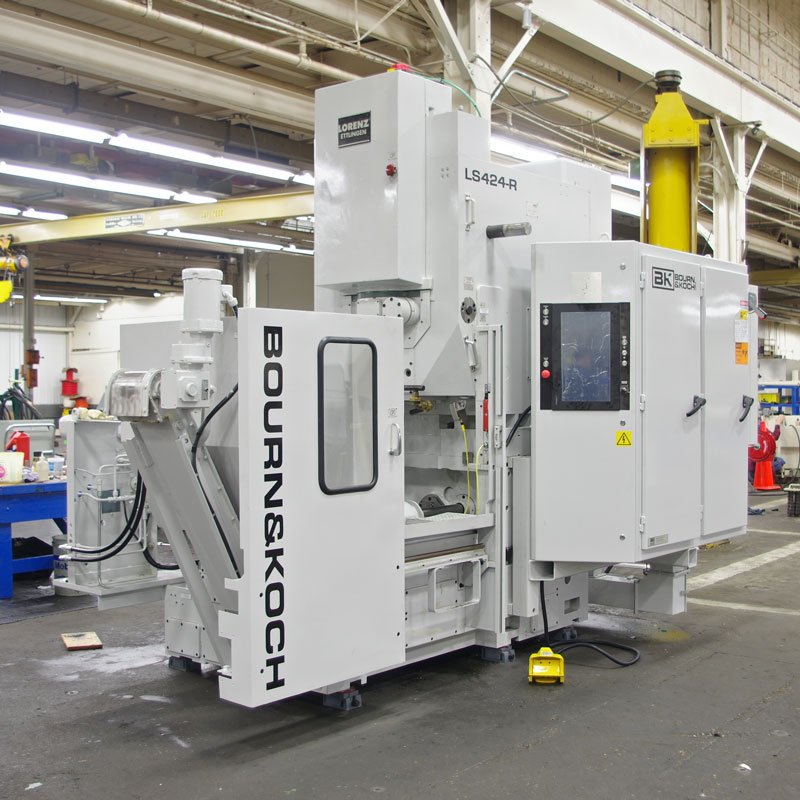

b&k cnc retrofitting
Standardizing with FANUC Controls
FANUC controls give machine tool builder and retrofitter Bourn & Koch the flexibility needed to get the most out of their machines, while simplifying design and production standards.
View Case Study

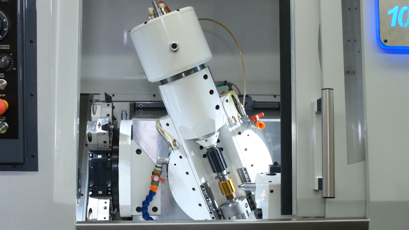

FANUC CNC retrofits benefit 5-axis machines
In the past, limited CNC technology made 5-axis machining inefficient, so that any changes in machine, workpiece, workpiece fixtures or tooling required revisiting the CAM system. With features such as tool center point control and 3D workpiece error correction, 5-axis workflow can now be as efficient as 3-axis with any changes adjusted right on the CNC.

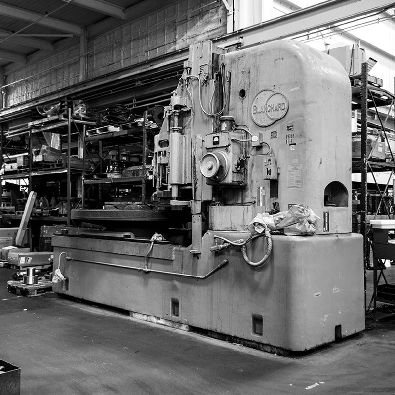

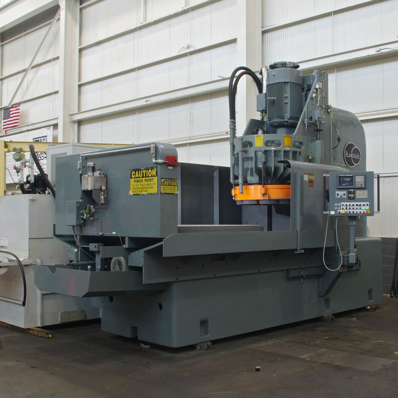

Blanchard machine before retrofitting
Before Retrofit
Blanchard machine after retrofitting
After Retrofit

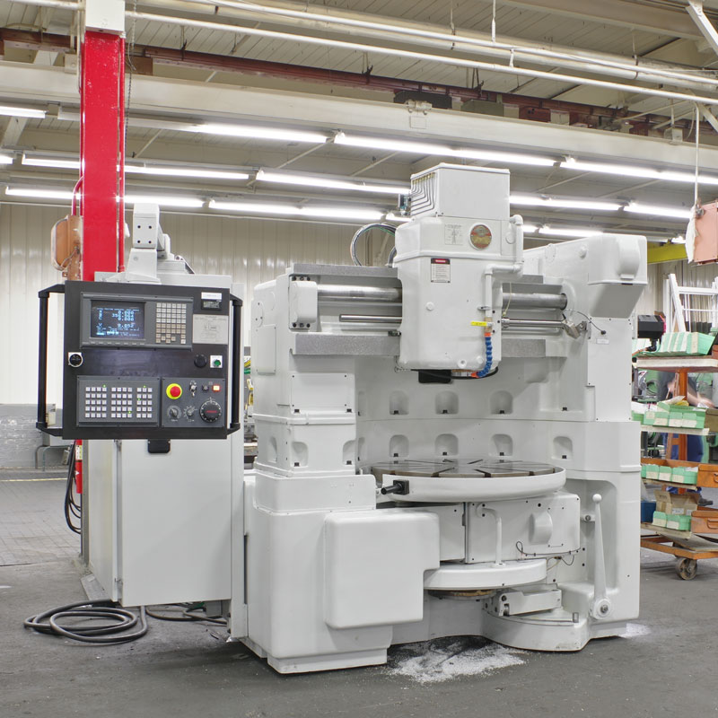

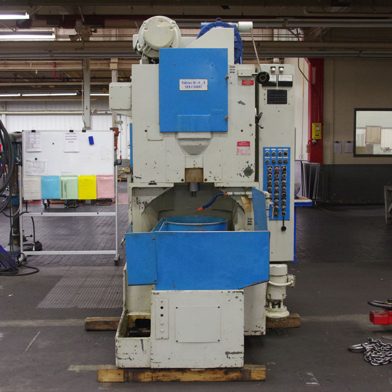

Fellows machine before retrofitting
Before Retrofit
Fellows machine after retrofitting
After Retrofit
Before Retrofit
After Retrofit

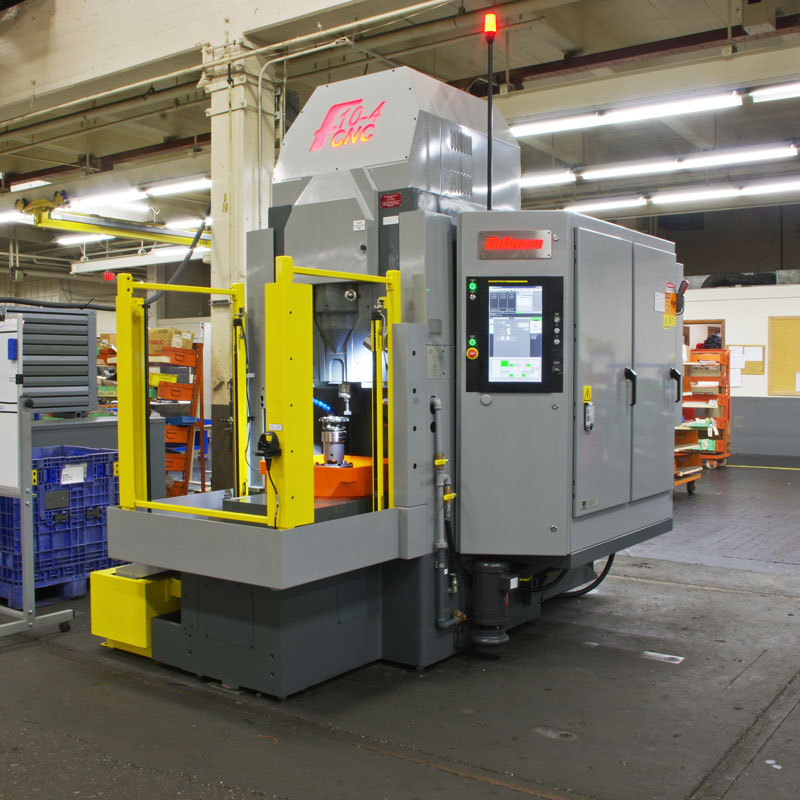

Bourn & Koch machine before retrofitting
Before Retrofit
Bourn & Koch machine after retrofitting
After Retrofit

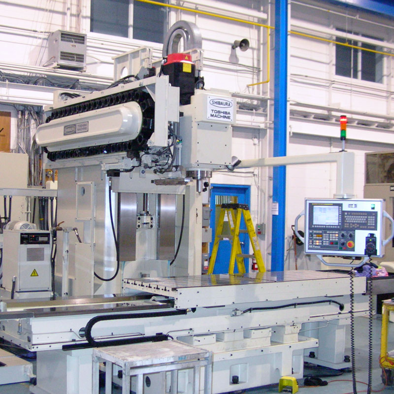

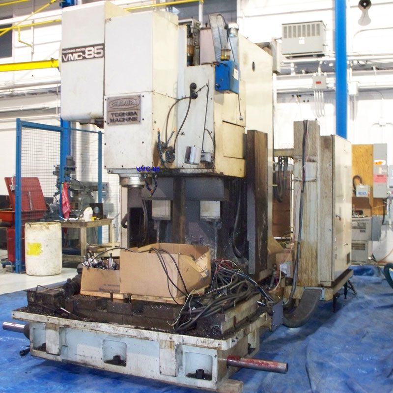

Toshiba machine before retrofitting
Before Retrofit
Toshiba machine after retrofitting
After Retrofit
